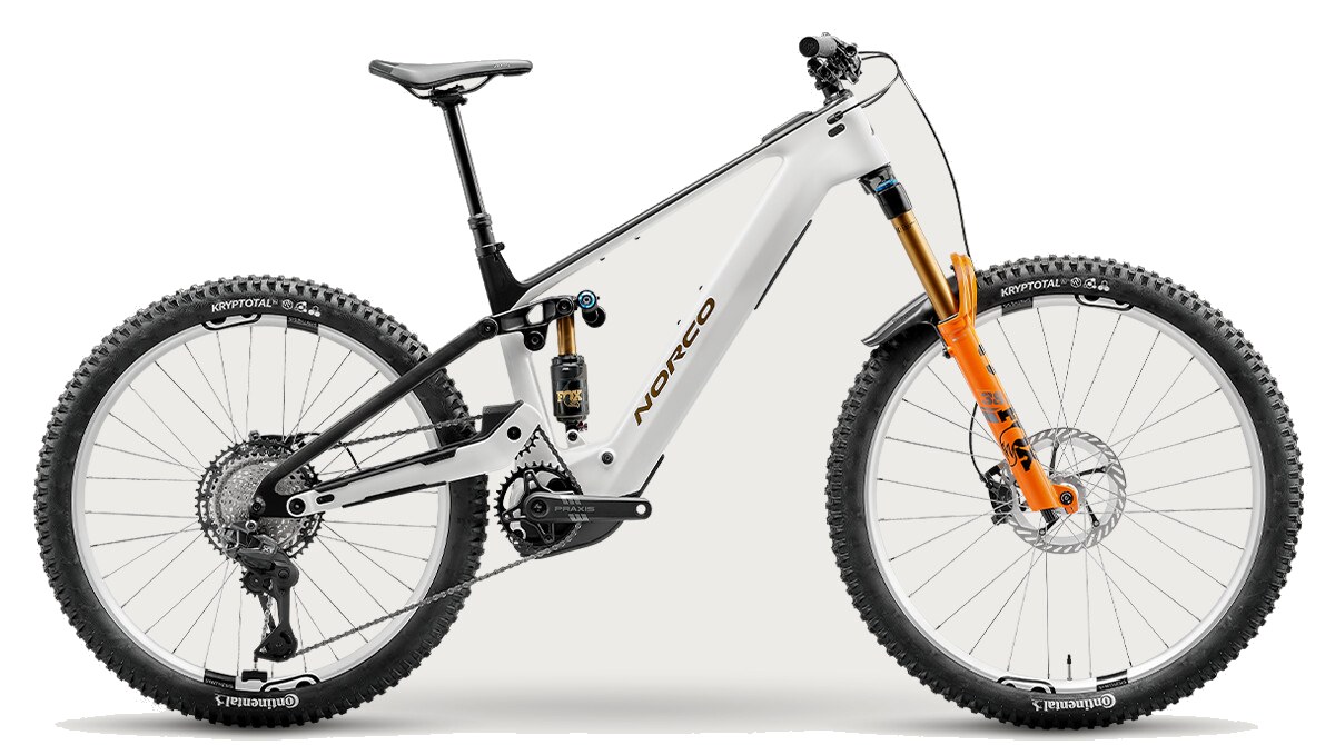

Norco Range VLT CX 2026
From £6,999
EMTB Forums verdict
The Range VLT CX is Norco's full-power e-enduro flagship for 2026, pairing 170mm of fork travel with 160mm at the rear through the brand's VPSHP high-pivot, idler-equipped suspension layout. It runs a mixed-wheel (29in front, 27.5in rear) setup with size-specific chainstays, a slack 63.5-degree head angle and steep effective seat angles from 76.5 to 77.5 degrees, marking it firmly as a descent-focused rig for steep, technical terrain.
Power comes from Bosch's latest Gen 5 Performance Line CX Smart System with the 800Wh PowerTube, the largest Bosch pack currently offered, plus optional 250Wh range-extender compatibility. Norco ships the motor at 85Nm and 600W, with an app-based upgrade to up to 120Nm and 750W and up to 600 per cent assist. Both builds use the same carbon frame and run a single 800Wh battery, so the choice between them is purely about kit.
The C1 at £8,399 is the performance pick: Fox 38 Factory and Float X2 suspension, Shimano XT Di2 wireless shifting, four-piston XT brakes on a 203/180mm rotor pairing, and Crank Bros Synthesis alloy wheels. The C2 at £6,999 saves £1,400 with a RockShox Zeb Base and Vivid Air Base, mechanical Shimano Deore shifting and TRP Slate EVO brakes on WTB wheels. Both keep the same Continental Kryptotal Enduro Soft tyres, Norco alloy cockpit and TranzX dropper, so the C2 holds the contact points while trading damper tunability and drivetrain polish for the lower price.
At a claimed 51.4 to 51.7kg, this is a heavy-hitting enduro platform rather than a lightweight, and the four numerical sizes (2 to 5) span a 441 to 516mm reach to suit a wide range of riders.
